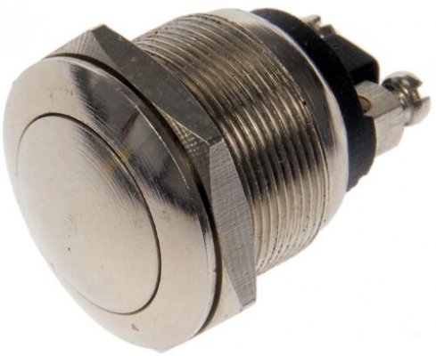

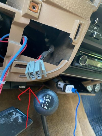

This is the flush mount button I'm going to use and mounting it under the dash just to the left of the 4WD lever. It should be pretty "stealthy" if I'm considering it a theft deterrent as much as a necessity (not that we have much theft around here). And it will be below my glow button, which is in the open space where that plug is hanging, so it will be convenient to where my hand already is after glow.
Dorman part # 84822 if anyone is needing one in the future.
