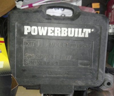

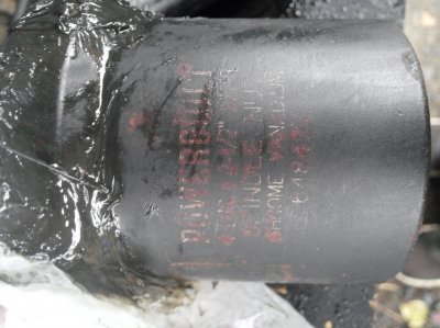

Here is the kit that I use. I purchased it at O'Reilly's years ago. And here is the socket you need. Sorry it's dirty and hard to read , I am in the middle of rebuilding my d50.
2 1/2 " 4 lug Inner Spindle Nut #648477
http://www.amazon.com/Powerbuilt-648477-Spindle-Socket-Inner/dp/B0015V1QF6
That will not fit. The shoulder on it stops it from going even close to the spindle nut. I got the exact same one from O'Reilly and tried multiple times, checked everything out, and it will not fit in there.
