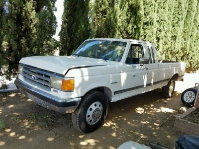

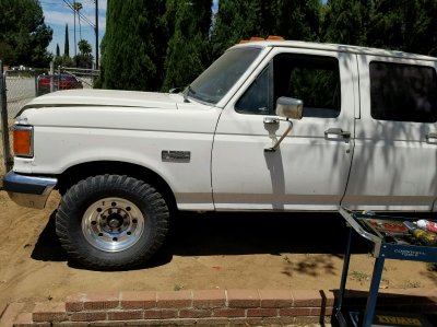

Started my suspension swaps...DRW to SRW on the CrewCab and SRW to DRW on the SuperCab (which also gonna get the 6.9/C6)
