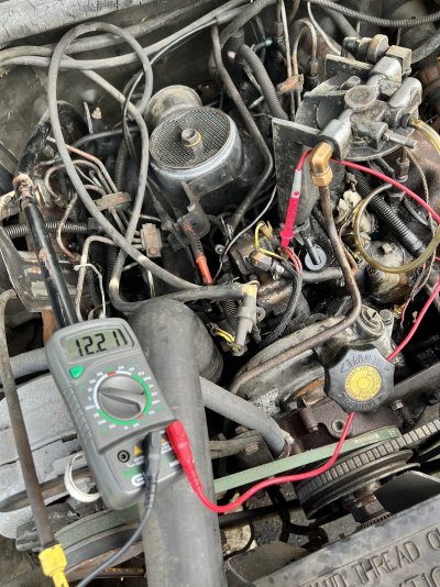

Next, you need to check the fuel shutoff solenoid on the injection pump at the top center of the engine. The thing all the hardlines are going into. You need to put a multimeter on the fuel shutoff solenoid connector checking for 12v when the key is turned to "on". If you listen to the pump while someone turns the key to on you should hear a faint click. If you get 12v when the key is on, continue on.
Final step, crack the hardlines and crank the engine until fuel comes out. If you reach that point let us know cause then we will tell you how to bleed it. If you follow those steps your either going to find your fuel issue along the way or it's going to be something like a bad fuel shutoff solenoid or pump component.

Hi, I verified that fuel is coming out of the shrader valve on the fuel filter head.
I’ve removed the fuel filter and am waiting on the new Wix to show up
I removed the unhooked AC compressor to clean up the motor bay a bit and to get the fuel filter off. It’s easier to remove the fuel filter on the truck version of the IDI than it is on the Van version.
Lastly, I verified that the IP is receiving 12.2v at the fuel cut off solenoid terminal when the key is left in the “On/Run” position.
