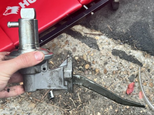

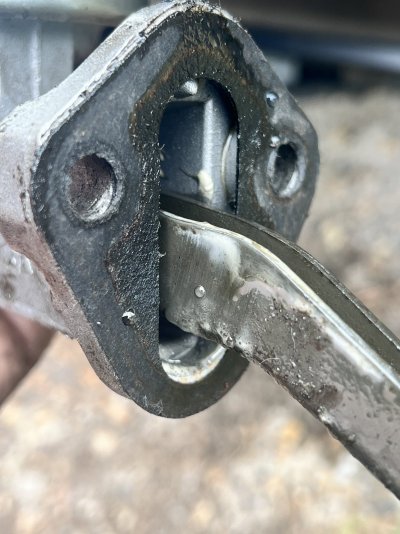

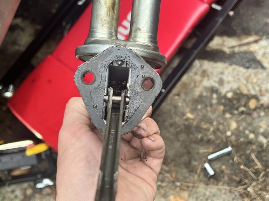

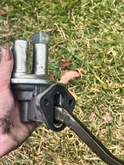

Hey everyone, I got in contact with the PO and they mentioned that the fuel lift pump may still be under warranty.
I took the lift pump off. Here are some pictures. The truck has sat for a year+ so I think that answers where the white milkshake came from that’s near the pivot of the lift pump arm.
Is it a smart idea to delete the mechanical lift pump and use an electric pump instead? Or should I stick with the mechanical pumps. I just want something that’s reliable

It's really a matter of preference, I think. If you're planning on alternative fuel, I'd stay with the mechanical pump. Though some guys say the Holley red and black will pump WMO.
Everything breaks at some point. Mechanical pumps diaphragm can tear, electric pumps motor will burn up.....pick your poison.
