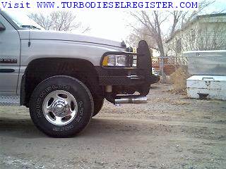

OK here's the story,
The ram air inlet has a buterfly plate in it that I can control from the cab, I also have a temp senser in the inlet air horn just before combustion, I maintain 70 to 90* at the horn and my milage has increased by 1 to 1.5 mpg, the cool inlet air also helps on EGT's. When it is raining or snowing I simply close the valve and suck underhood air. from the back of the inductor I have 2 pipes of 3" diameter feeding the filter, I have since gone with the progaurd AFE and tossed the BHAF and also painted the ram inlet black to match.
Dont pay attention to those punny wheels as I now have 19.5's on
Cheers, Kevin
