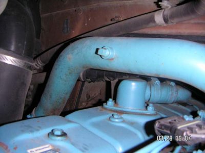

....huh, I just found where the stock boost tube goes into the DTA's intercooler. There's a removeable NPT plug right at the top of the intercooler for a boost tube. Dang!!! I wish I known that before I drilled & tapped. mark, get ahold of me if you do this gauge, i can show you where to tap into the I/C. :thumbsup:

I have a plug on the pipe that crosses over the motor. I wish I had an aftercooler :D

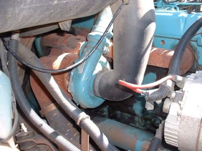

I'm not sure whether to drill the manifold or the downpipe and use the clamp mount to secure the probe. Here is my 91's turbo/mani

thanks mark. i was sort of thinking on the manifold top side,towards the front of the engine,or on the down pipe ,just below the bend. the mack i sold a few months back ,had it on the down pipe,just below the elbow. like yer picture,gotta get me one of the digital picture shooters,something about that blue engine,just makes me feel all warm and fuzzy!

I'll see if I can take a picture of my pyro probe. Mine is between the the black plastic/rubber tapered intake pipe and the turbo itself. In between them is a space big enough for a drill. I drilled & tapped it there. Fits good.
Mark, do you trust the clamps? I like to tap the hole and use the bushing they give you with the pyro.
I don't like drilling on the top of a manifold b/c the shavings tend to fall into the manifold then get into the turbo. I know the chance of damage is small, but I didn't want to risk it.
I put grease on my drill bit to keep the shavings stuck to the bit.
