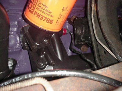

Photobucket still isnt letting me upload any pics.....the port on the oil cooler is right above the oil filter, and maybe a little to the right. I think its a regular 6-point head, but I havent looked in that area in a while.
386
There are also two places on the crank rail that you can use for oil presure or temp. One is right at the back of the block where it meets the trans, and the other is ahead of the oil filter. Both are on plain with where the oil pan meets the block. Check out my FS-2500 pictures in the Moose TRuck album for photos.

GADS! Chris, how could you! HOW COULD YOU!
Put a FRAM filter on that pretty engine???! :puke:
:eek::eek::eek::eek: there must be a good explanation for this like......it was just a placeholder for clearance?
back on topic, if you cant get the probe in the pan i would agree the oil cooler would be the next best thing.
