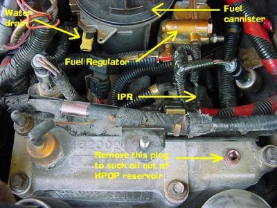

My buddie just bought a 99 F250 with the psd of course. It has a fairly new Ats turbo and a 6 in Rancho lift with 35 in BFG All terrains. I belive it has a fuel metering block mounted close to the hpop. I am wondering how to turn it down. He is only getting like 12 mpgs and is tired of it. It aslo has a air tank where the spare tire should be. There is crossmember or something that was removed behind the transfer case area. Plus there is a switch thaat is activated when the hood is closed. Plus a 5 inch screen in the dash that does nothing. We find more stuff allmost everyday. One thing that I have never seen is on the tranny coller lines there are unions. on one lines there is a drain deal??? The big thing getting better fuel mileage!!!! Any help would be greatly appreciated.

have a picture of what you think is a metering block?

Edit: Could this be what your seeing as a fuel metering block, the fuel regulator? There was a few changes made from early 99 to late 99 they call 99.5.

My phone wont let me look at the picture any bigger. I know for a fact that this metering block is after market as the fuel inlet lin on the fuel bowl is cut and folded over. the new line comes from behind the turbo into the block and the out towards the passenger side. it has a nut on top with a allen head piece in the middle of that. I will work on pics tomm. I may have said this allready but I know the 35s and lift dont help but I thought it should be getting atleast 15 mpgs not 11. Been spending so much time in the shop I havent had time to talk to my buddie but I will deff gtets pics sent to my phone tomm and have to downlaod to email then photobucket so bare with me fellas. If my good phone was working this would take less than 5 mins now itt akes 3 days. grrrrrrrrrr

thats a fuel pressure regulator.somebody did the regulated return mod on it.the 99-03 psds didnt have a fuel return system.
