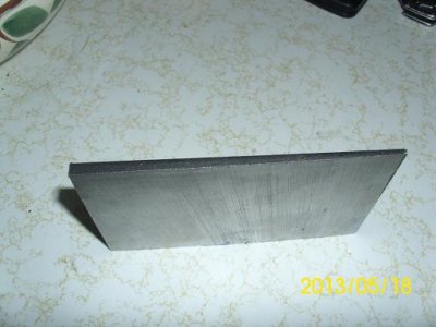

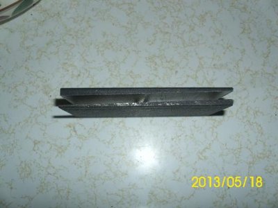

I may be a little obsessed with my u- joint angles. Ever since I installed the gear vendors the drive line has never been quite as smooth as the original. Not bad but just not as smooth. Finally got the vibration almost to zero just a slight tingle in the feet, to achieve this I shimmed the front and middle u-joint to tenth of a degree. My rearend is off a whopping 1.5 degrees off and pointed up not down in relation to the driveshaft. Not wanting to spend 40 dollars on shims, I started looking at my mill. Mill vice is to small to hold 3" stock. Plan b make jig to slice 3/8" flat iron on the band saw. The plus with the bandsaw is I am not wasting half the steel with the mill in the form of chips, and it is cheaper and faster to operate.
Here's the results.
angle is 1.5 degrees and the height is within .030" of the two. Should be close enough.

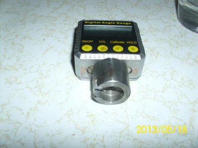

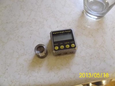

Angle finder and a little homemade tool to attach angle finder onto cap of the u-joint
The slot is to clear the locating tab on the yokes. Only way I have found to take consistent and accurate measurements without pulling the drive shaft.
