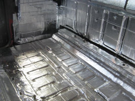

offroad-anarchy
Feb 6, 2026
36
48
somewhere in UT, MT, ID or WY
Wow, what a push that took to put this whole interior back together. Still working on recovering my seats, so haven't put the passenger and rear bench back in yet, but oh my is this thing way way way more of a pleasure to drive with all the sound deadening, head liner, felt, etc....
Not so sure I would do it again by myself, but now that its all done seems way worth it.
Anyway point is, the Dynamat type butyl foil sound deadeners are worth it if you take down to the shell. Replacing all the loose panels, missing screws, press buttons and all really take an old clunker and make it somewhere you want to be.
Again, thanks for all the tips in this thread and hints on how to get it done.
Cheers, Pete
