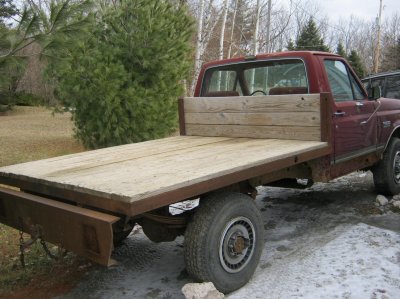

Finally bought my first diesel, sticking a good amount of cash into it in just the first week and hope I don't regret it. Picked up a 90 reg cab 250 4by 5spd XLT Lariat. Was dumping more fuel on the ground than it was burning.
So far I've replaced the autolite glowplugs with ZD9's, new return kit, tested the glowplug controller and harness. Pump should be back today or tomorrow, having K&S Injection in Wausau do the rebuild. The farmers I work with ALL recommended them, full rebuild and setup for under 500.
Also tracked down battery drain to a few crappy grounds, slight corrosion at the bulk head connector and replaced all battery cables with 2/0 welding cable.
1 quick question after this long winded start, when you guys that have done true dual exhaust, what size pipes do you go with after cutting the Y pipe out?

2-2.5 is more than enough. You have to remember the manifolds are only that big so any bigger is a waste.
nice looking flatbed

Welcome to the site! Love the flat bed. Looks like you're on the way into a nice love affair with that nice flatbed :)
