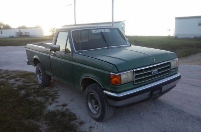

I have a 1991 ford f150 scsb 4x4. I have been researching about going carbureted on then said forget carbs and ive decided to do what i really want. Drop a diesel in it. Now before people get into frame and axle strength drama. Its getting boxed and sas with 1 tons.

Heres how she sits

cpdenton
Truck needs paint.
