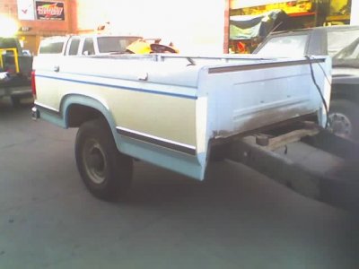

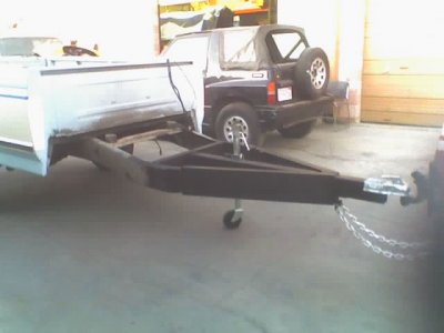

my dually doghouses are bulls-eyes for collisions to begin with, so imho, trailer is a really bad idea. My buddy Tanker Tom built a trailer from a reg cab frame and he really went long on the tongue length. here's a couple of pics of it....

tghe ****** hick that built mine out of a 1960 ish Ferd box, gave me 7' or so of tongue...
It is so well balanced, that right now squatted fully, I can lift and drag it around the yard, I have not weighed this load yet, but the last load was right at a 1000# and it handled the same.
Which is kinda cool, but on the other hand, I load tongue heavy, and if at full load there is no weight on the tongue, well, its a whipper for sure.

Calvin, that looks like one very beefy tongue your friend built there! It probably helps with weight distribution tho.
