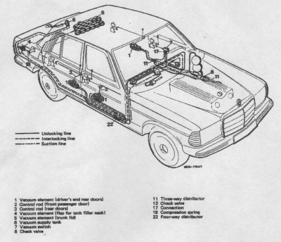

Well I got hold of a 2.2 MBZ diesel 4 cyl.With the Orig.5 speed manual trans.
This is going into a older Mazda P/U .DOES ANYONE know a wed site that has all of the Vac.lines for all of the years on it? or any other pertent engine data .So far I have not been able to come up with this info on line.
All suggestions greatfully accepted!

For what it's worth, the only vacuum component you should need to worry about on the engine is the shutoff valve on the injector pump. Any other vacuum lines should be going to the interior components (locks, climate control, etc), or there may be some plugged lines that were meant to help control an automatic transmission.
You might try this link: http://rapidlibrary.com/index.php?q=w201+service+manual+pdf A 2.2l diesel and 5 speed manual would have come out of an '84 to '86 190D (W201 chassis). This may help you with your search.
Hope that helps some...good luck!
