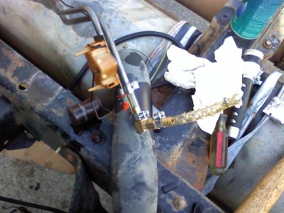

The pickups are on the bottom but they are typically broke off so you can only get down to 1/4 tank. Your truck is newer so maybe not.:dunno
You can pull out the pickup/sender assembly and attach a piece of hose with a fishmouth on it to get to the bottom.
I assume you know what a fishmouth looks like being a pirate and all.:rotflmao
Here is what I did.
