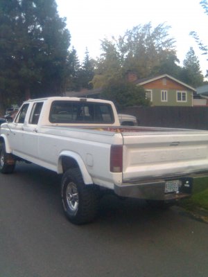

Here are the pics I have of the truck so far. I'll get better ones soon (These were taken with my camera on my phone).
