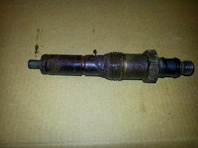

Today was the warmest day on forecast until March, It hit 32 degrees!!! So I went out and got my IP and injectors pulled to prepare for a full refresh.
Everything went smoothly. However, I do have a few questions. Firstly, what should I be using to plug the holes where the injectors were. At this point, there is nothing covering them. Secondly, some of the injectors looked pretty rough, and some had some buildup below the copper washer. Is it necessary to clean out the bore before the new injectors are installed?
The injectors are marked 7/90 (The manufacture date?) and have a D stamped on the side of the hex. BB are the recommended type of injectors to reinstall, correct?
Attached is a picture of the worst injector. It had some goo and rust all along the body, as well as some carbon on the tip.

That is nasty. How'd it run?
Some say the injector coding is irrelevant as long as the pop pressures are good. Many say the BBs are the ones to get. Since they cost the same might as well play it safe and get the BBs.

Nothing to prep, just clean it up on the outside, you could take some cling wrap and cover all the openings on the outlets so dirt don't get in there, do that first before cleaning the outside. Then put it in a ziplock bag before sending it so any fuel that leaks out don't contaminate the package. Those injectors are probably not the originals, or they would be painted gray. Stick them back in the holes after cleaning out the carbon in the holes.

As far as the injectors, I believe they are the originals, there is gray paint on them, and the one in the image has a bit of gray paint on the hex head, though most of it is chipped off.
Whats the best way to get the carbon out of the injector holes?
