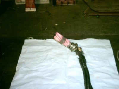

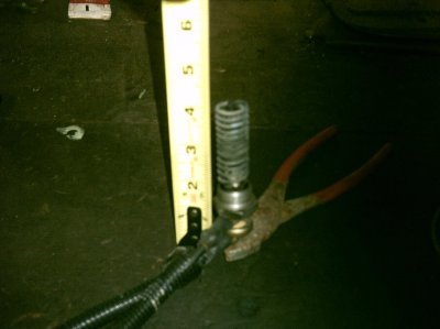

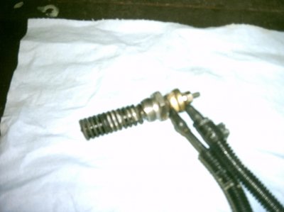

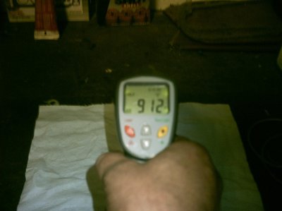

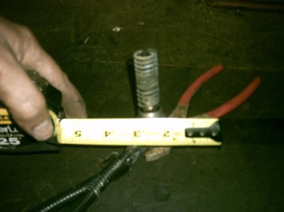

00 PSD Intake Heater Test
Got one of these from work today and tested it out. After 20 seconds, it was over 1000 degrees F". It was wired into the GP solinoid. Gonna try to rig it up on my 92 7.3 this weekend.
That looks like you could fit it into the CDR hole in the manifold. Hmmm.......
