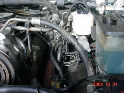

Installed# 1, I did last year. And that was upgrading to a 130 amp alternator.
Installed# 2, I just did this week. I installed the hydro boost I acquired a few
weeks ago. I am very impressed with how much of a difference
this conversion makes. It's nice not having a brake pedal feel like
your squashing a plum. I tested it and locked up all four wheels.
That's was a first. Plus with the big vacuum booster gone, there
allot more room to work on the driver side of the engine. This

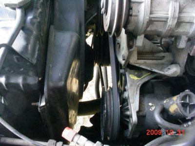

power steering pump has the double belt pulley on it. The one I
removed off the truck was a single belt. Now I need to go buy
another belt.
