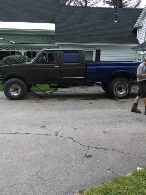

Hi guys, I have a 93 f350 that I swapped from duly to singles, and I wasn't o replace the 7.3 idi with a 7.3 power stroke. I know that I will need a new harness, but do I need to change anything with the frame? Thanks

Pretty sure you will need at least all the wiring for the engine, the dash and the instrument cluster itself.

I think you need the gas pedal too. Seems like the strokes are drive by wire....

Need all under hood wiring and IDM , dash wiring,PCM and bracket throttle pedal.
When I did mine I put the power stroke and Radiator brackets in, overflow and washer bottle
I used a 96 wiring in my 93.
Had to change a few pins in the connector for the back lights.

Thanks guys, I worked 17 hours non stop yesterday, all night actually, and got it in! I'm doing the wiring as we speak.
