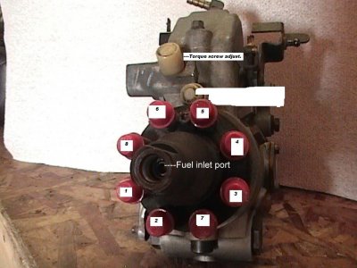

I think you might mean #2 or7, they are on the bottom. If your gonna pull the IP, just leave the lines on, with a little wiggle they come out. Check and see if that leaking line is cracked, if you don't have all 4 line clamps on, it could very well be cracked.

Yes, #2... Must have gone crosseyed looking at the lines. I did manage to get a crows foot in there and try to tighten, would not go tighter. Loosened it a bit and retightened. Still leaked. Loosened again and loosened at injector, wiggled line a bit as tightening. Repeat that a couple times and still leaks. Not sure if I just an not able to get it tight enough at an odd angle with crows foot and extension or what.

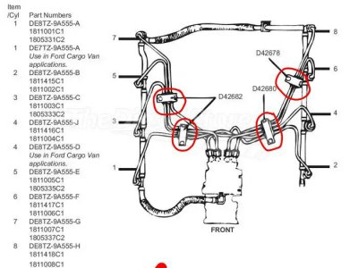

I am missing the first clamp on drivers side bank of lines, I can see on the lines where it used to clamp over all 4. The second clamp over three lines is there. My lines do not look exactly like that diagram. Wonder if it's cracked. I think I'll need to pull the pump and see what's going on.

Sorry to tell you that line is cracked. Anytime your missing the line clamps you will break or crack a line. How did the clamp end up missing and how long have you driven it this way.

Thats a crack. Sorry but a new or used line is needed. Any number 2 line will work. Meaning it can be from a van truck or international 1600 dump type truck. Or uhaul rental rigs. Please get the line vibration damper too and install it. I trick I discovered years ago about those way too short bolts. Increase the length to either 3/4 or 1 inch. Then stick the nut to an open end wrench with some electrical tape. Use a small pair of channel locks to hold the 2 part clamp together and stick the longer bolt thru the clamp. My fingers wont work holding the nut under the clamp so I figured this method out to ease the job.

Good deal on that set of lines. If you bought a set of lines for a van engine application be sure to move the timing adapter from number 1 hard line to the number 4 hard line. Of just use the truck number 4 hard line. The van hard line kits have a shorter number 4 line because the old unused timing adapter is found on that cylinder instead of on number 1 cylinder. If we want to eliminate this adapter for either the truck or van lines we just buy the hard line for the other application.
The vibration clamp rubbers don't wear out but replacing them illuminates all doubt.
