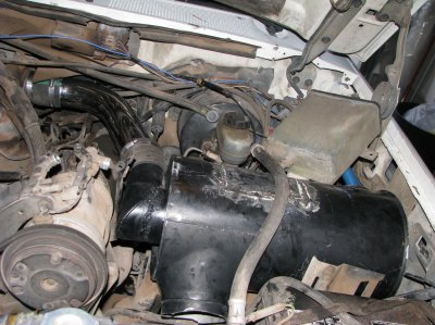

The air filter setup is great. I did a lot of research and found some info stating that even the early power stroke intakes were to restrictive and needed a filter change at every oil change to be at all efficient.
I know I am getting a lot more airflow through that thing than what it was getting. I will post a picture of the un airfilter and intake system that was in the truck when I got it, not long ago. Also the second picture is of the new canister filter system I adapted.
Still need to finish cleaning up my welds and get the can painted and relocate the radiator overflow and wind shield fluid tank. It will be worth it though.
