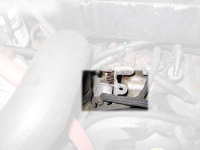

This is the actual solenoid
It and the timing advance solenoid are both controlled by the two prong sensor that is in the passenger side head at the front underneath where the top rad hose goes (an expensive part so treat it gently). There is 12V+ going to one side of the sensor and at less than 112* the sensor provides 12V+ to the terminal on the injection pump (IP). With 12V+ to that terminal it advances the timing and activates the solenoid shown. As mentioned above when you turn the key on you must depress the "go" pedal to set the high idle (like the old gassers with the bimetal thermostat). The factory recommendation is to depress the pedal half way at temps above 32*F and depress the pedal fully at temps below 32*F while cranking. Are you getting a good 'rattle' when starting cold even if the high idle does not 'cut in'?
