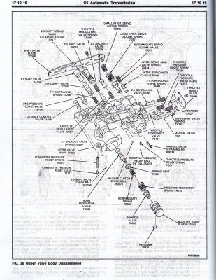

Maybe these could help.Could you have left one of your BALLS out? :D LOL
Edit: Oh crap,the modulator pic is upside down, ain't gonna change it, just print and flip it. :D
