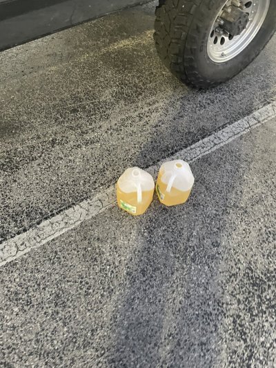

Update here. I had the same idea. Swapped around to the good end an through some fuel line on into the cab. I’ll make it home in time. She’s lookin pretty hard. But running strong not letting me down. Picked up a hitch hiker in the Wally World Parkin lot. He’s holdin the jugs lol
