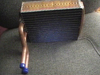

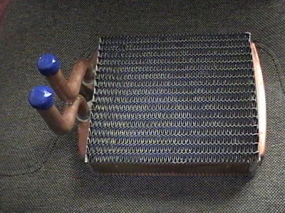

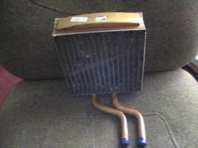

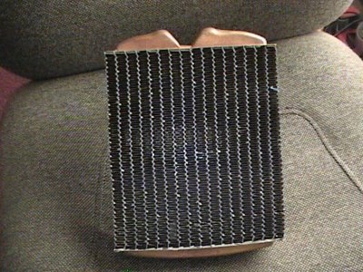

I've got 3-4 of these heater cores, $45 shipped. They are Ford trucks, lost the info on them.
