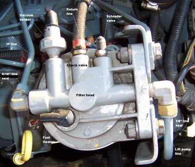

ok i just finished my gauge install with the exception of the furl pressure sensor.
now on the filter head where the line does to the ip just to the right of it there is a one wire sensor what is that sensor an could i tee in to that port for my pressure sensor. secondly i am acquiring the parts to swap a zf5 my truck has a good auto trans with a us gear between the trans and transfer case which is also in good working order the question i have is whats the us gear hi low worth and what is the trans worth as i would like to sell them when the swap is completed. thanks for the info

IIRC that port has some sort of vacuum sensor to detect restriction. Removing it wont cause a problem and the last time i looked all three ports were open to the same path of flow so it should be ok.
