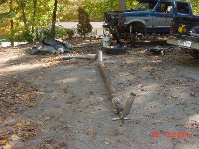

Here is where I got my 5" tailpipe here http://shop.ivalueinternet.com/shopdiesel/index.cfm/action/productdetail/product_id/214.htm , and my brother inlaw got me some 5" water pipe to go to the tailpipe. I am still working on getting the exhaust in, but will report back when it's installed. I ended up getting a 4"to 6" stainless tip at a farm show from http://www.scheiddiesel.com/ford_exhaust.htm , the last tip on the bottom of the page, but got it for a show price for $40 :thumbsup:. Here are some pictures of the exhaust that going on my truck.
