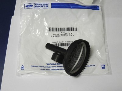

If you mean the shower heads, ebay or amazon have them. Between 35-40$ each. Listed for newer trucks but they sure look the same to me.
342
Ya don't want those filter socks, there OK for gassers but not for diesel.. Here's what you want for in tank. Pretty sure that same filter is used from 83 to 2016.
