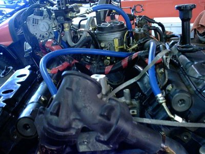

I still am running it. I have had it for 30,000 miles. When I added it I needed it for the MM injectors. It supplied the fuel for 475 rwhp.:) It also appears to be built alot better than the stock pump and flows ALOT more. Kinda spendy though. With the billet sump they go for $845.00 My buddy Nate at performancetruckproducts.com sells them. I got mine thru him. Also dieselinnovations.com can hook ya up. I also run the Diesel innovations regulated return dual feed fuel system on the engine.

here is a pick of the dual feed regulated return
