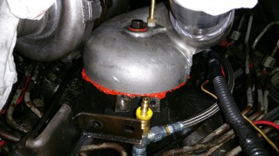

I have a cat filter and pump in one, havent started the truck with it yet but it should work fine. At the brass barbed fitting by IP i am installing 5psi poppet valve to keep pump charged to 5psi but still bleed air out. The cat filter is a 5 micron filter, i got a 10 micron pre filter for it. The relocation has allowed me to run a water cooled intercooler on the driver side of engine bay, and on the pasenger side install piping straight into my turbo and make a true cold air intake.
