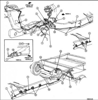

Does anyone have a part number for ford or aftermarket to get the little 3 clip tabs that go on the frames that hold the fuel feed and return and brake lines on our trucks? Tried searching for something similar, but all I find are those silly billet ones that are $25 each!

The right number for that clip is N802770-S or N802770
here are the number for the pic.
1 2078 Front Brake Hose
2 N802768 Single Clip
3 2264 Front Brake Tube (RH)
4 2263 Front Brake Tube (LH)
5 2264 Front Brake Tube
6 N804645 Clip
7 2078 Brake Tube
8 2814 Brake Hose Clip
9 2C267 Tee Assy
10 2B373 Anti-Lock Brake Control Module
11 383057 Union
12 N802770 Triple Clip
13 2C190 Rear Brake Anti-Lock Sensor
14 2267 Rear Brake Tube (RH)
15 2267 Rear Brake Tube (LH)
16 2265 Tube
17 N620398-S36 Anti-Lock Brake Control Module-to-Frame
A – Tighten to 17-23 Nm
(13-17 Lb-Ft)

I'll call ford and see what they say. I was going to do the clips, but with the lines all on one side there's going to be 25 clips going down the frame on everything. I think it'll be a cleaner job with the triple clips.

From ford it's an 8 pack for $16. From sunrise Ford it's $10 for 8. Perfect. Thanks guys.
I'm probably going all down the driver side on the travelette. Everything comes out of the firewall there and the fuel pump is on that side.
