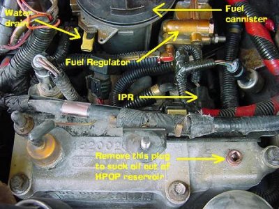

same place as the idi on the oil cooler.the oilpressure sensor is in the HPOP reservoir in front of the fuel filter housing.ive never heard of a PSD with a bad oil pump.should be around 10-15psi at idlewarm.and 40-70 psi at 3300rpm warm
338
I think the oil pressure sensor is the gold one on the HPOP reservior to the left.
