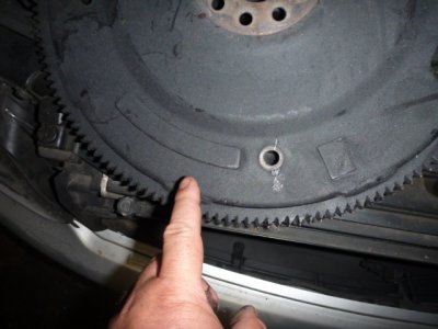

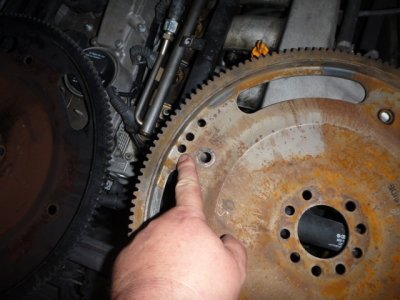

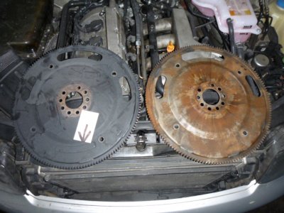

flexplate differences between oem turbo motors and non-turbo motors.
1,442
pics are worth a 1000 words. besides, I'm too lazy to type.:D
1) the non-turbo motors have balance holes drilled into the flexplate.
2) the oem turbo motor has additional balance weights added to the motor side of the flexplate.

Interesting information. I just looked at the picture of one of my flexplates. I assumed it was from a factory n/a motor. According to your pictures, it is with one difference. Mine only had 2 balance holes drilled in it. Now I want to get home and look at my other one that was in my truck when I got it. Thanks!
The question now is, why the difference? They are all internally balanced engines right?

1,442
compensating for something....larger wrist pins perhaps?
bingo.
since there isn't any difference in the cranks, there has to be compensation somewhere else in the rotating mass.
only reason why I posted the pics was there was a question at one time about the differences between the two. I just happened to have both handy for the pic opportunity.
