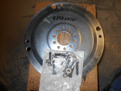

If you search autozone.....it is the same part number for a 93 model vin M as a 1989 NA diesel truck. Probably won't be any different than any other one. Visually, they look very close, just the weight is in a different spot...
342
With this Ford PN. F3TZ6375A.
You get this, 6375
Ford Flywheel/Flexplate
7.3L; IDI turbo w/E4OD.
$702.87
Looks to me why the price is that high because you get the CastIron flywheel, ring gear, 1" spacer, TC flexplate and bolt backup ring.
If this is what you already have, which Ford says is a cast iron Flywheel, thats why the cost is so high, they just don't use them anymore IIRC. The C6 takes a different Flexplate for the TC to hook up. The C6 flexplate is a smaller bolt circle IIRC than the E4OD TC.
To clock the Flywheel for balance (which I have never done), I've always marked crank and FW or FP) but it would occure to me that the (weight if any) or the drilled balance holes would have to be inline with #1 cyl at TDC .
Personally I don't know why you can't use the flywheel you have, that engine don't know whether it's a C6 or a E4OD.
If you need a C6 flexplate, I have one. For only $702 :D LOL AFAIK they are obsolete also.

The turbo flexplate is just a stamped steel plate with the 1" thick spacer. The c6 used the cast iron flexplate with a stamped steel plate bolted to it using the crank to flexplate bolts. The torque converter for the c6 and E4OD are the same bolting pattern and spacing and size, if you had a non turbo 7.3 you could swap them all day with no issue.
The bolt pattern on the crank is a 10 hole pattern with one hole not drilled out used as an alignment point, you can't put the flywheel or flexplate on wrong with the pattern they used. Also these engines are externally balanced so the correct flywheel/flexplate is crucial.
Ford86, if the part number on the flexplate is listed for an 89 like cpdenton mentioned, it will be the wrong part, remember that part houses are very stupid when it comes to 1 year changes in vehicles and they clump them to other years say that they are all the same.
