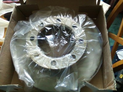

I got my brake rotors and axle joint today. I was talking to Bigrigtech this morning while "working" downtown on the water line install lol.
I want to try and get down tomorrow and throw the rotors on, and replace the bad axle joint. I also have to replace the bad track bar bushings with the new poly ones I got.
The truck should handle like a brand new one when I am done with her!!!

Ok, just an update. I installed both rotors (remembering a thread that highlighting to make sure the wheel studs are driven back in their appropriate "splines") to ensure that they don't spin in the hub while tightening/loosening wheel nuts.
I also installed the passenger side axle joint (also making sure to not hit the inner seal)
Then came the job of beating out the old track bar bushings and replacing them with the new ones....That was fun. Had to use the fire wrench to get that done.
Other than that, the bearings, ball joints, pads and calipers are BRAND NEW. I will be using my D50 calipers to save from bleeding my brakes (which is pointless because I will need to bleed them when I do the dually swap in the rear anyways)
