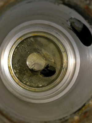

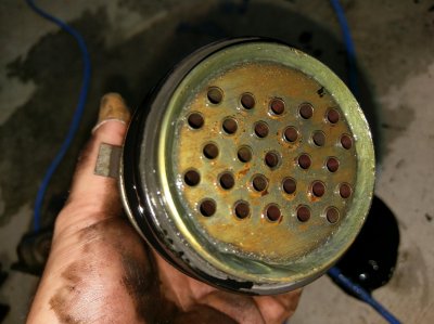

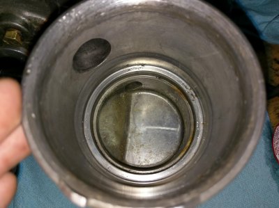

Here are pictures of the 1994 turbo IDI cooler i just pulled apart. It had 168k i dont believe its ever been rebuilt. A brass wire wheel would clean up the small outter corrosion and seal just fine. Putting inside on the inside oring seat is usually where ive seen the most pitting because the copper tubes are so close to the aluminum there.

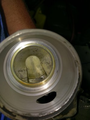

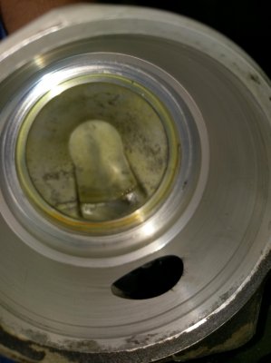

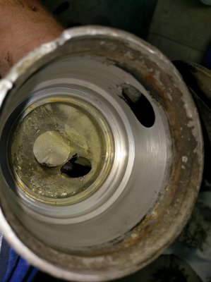

Here are a couple pics of the slightly pitted PSD cooler i just did after cleaning. With the Boss 820 lube 1,000 miles its been leak free
