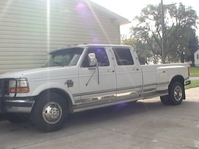

I had the exact truck you have. I went to Greenville SC and with a 25' gooseneck trailer loaded a F350 (see pic) and hauled it home 800 miles with a lot of mountains. No problems at all with the tranny, had a Trucool 40K aux trans cooler. 92 truck 7800# - trailer 2700# - 90 truck 7200#. gross weight 17700#, weights might not be exact, but close as I can remember.
I also pulled a 30 ft 5er 8500# with the 90 many miles, never had any gauges, just relied on the coolant temp for reference, but gauges as said above would have been nice.
