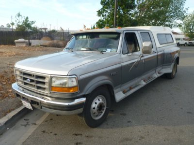

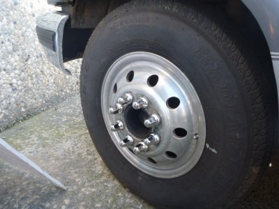

Do you guys know if that 1993 10.25 will have 9/16 studs with 1 1/16 lug nuts like my truck does now?
Dieselcrawler
Professional wrench holder
Staff member
Jun 4, 2010
5,292
650
Quakertown Pa
The stud has been same size for years. The nut size has jumped around. But even the 94 dually I had used 1 1/16 nut.
1,442
the smaller 7/8" dually lug nuts have no problem tightening down on the 9/16" studs.

So I can run my 1 1/16 lug nuts regardless? That's comforting. My OCD was creating a mini panic attack thinking about 2 different sized lug nuts on my truck lol
