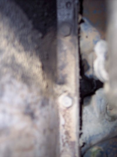

Barring the oil pickup location, would one be able to flip the pan front or rear? IDK if the bolt holes are symetric or if the front and rear main cover humps are the same size/shape.

I think the pans are symmetrical, minus the oil pickup, but with a Welder that's something that could easily be changed
Without ever having the thought to measure, I do believe that the holes are symmetrical. The one thing that could nor be changed without A LOT of effort (and still may not work) is the fact that these oil pans have a relief along the rails that mount to the block. This is foe clearance for the dipstick. In fact, I think that the bulge, relief, what ever else someone may call extends downward (when installed) into the side of the oil pan. This is the best picture that I could get tonight. You can barely make out the bulge in front of the lighter colored (not oily) bolt. I can get a better picture tomorrow if someone wants one. Instead of trying to move this bulge, I think that it would be easier to cut the bottom of the pan off right below the rails and flip it around 180* compared to the rails.
