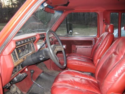

Somebody say seats? As for the tear, they all rip there because of sliding in and out of the cabin. That part always takes a beating.
