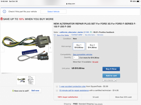

You’ll need these plugs plus upgrade charge wire from alternator to fender relay. Should be able to find these local. Picture is for reference.

If money is tight you can get an alt at a salvage yard and grab the pigtail while you're at it.
