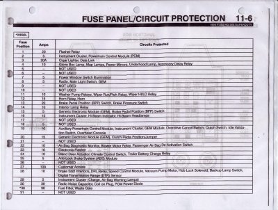

Check the 5 amp fuse #29 in junction box in the cab under the dash. Edited.
338
Here's your circuit.

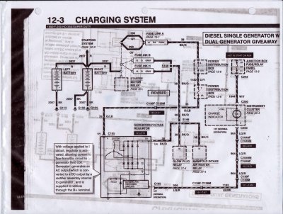

Now, on that diagram, it shows one light green/red wire going through the lamp and to the fuse.
Where does the other one go?
There is 2 in the plug.
338
Here is another circuit diagram, all the circuits I show are from the factory 99 wiring diagrams. Have no idea of what they mean by GIVEAWAY.
The second pic is of a 3G Alt. maybe you can figure it out from that.
