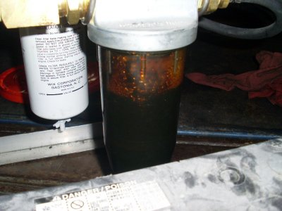

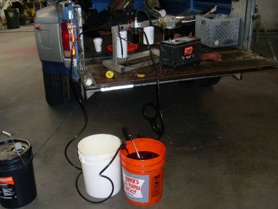

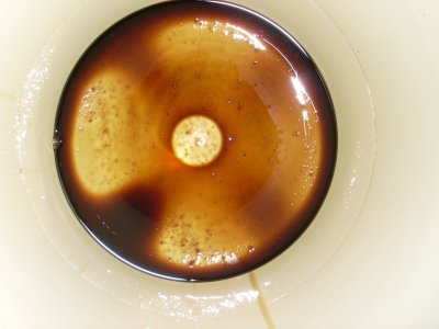

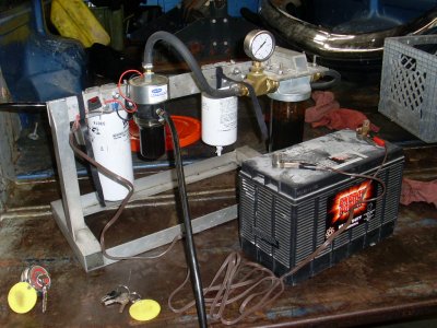

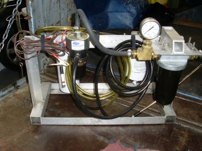

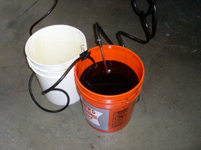

here's some pics of my filtering rig at work. 2 5gal buckets filled with 50% jetA and 50% WMO. each bucket sees about 45 mins to an hour of recirc filtering. it does make a difference recirculating. the gauge sees 2psi restriction at the start of the run. by the end of 45 mins, there's less than .5 psi restriction. I've seen as much as 5psi restriction and I add more jetA to bring down the pressure.
so far the truck has run three 10 gal batches of fuel. with the avg. price of fuel at $4.09/gal, a rough savings of $122.70 was realized these last couple of weeks. I have no complaints.;Sweet:D

A word of caution. Jet A does not have lubricants like No2 diesel. You need to add some or your IP will suffer quick damage.
Other than that issue, it's a fine fuel for your diesel truck. Same base stock as schedule 52 fuel [pump diesel] just adjusted to work in the extreme cold of high altitude flying. Adding lubricity elements raises the gell point so airplanes can't live with that. [fuel in the wing tanks gells up, you fall out of the sky].
Enjoy it, use it.. lube it up and use it.

As long as you are mixing WMO, you will have plenty of lubrication. No worries, just dont run jet fuel by itself.
