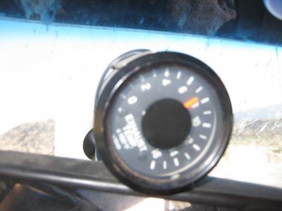

if you want a bulletproof tow rig, put in a intercooler. my exh system is a 3in straight pipe from turbo to rear axle. 4in over the axle and out the right rear. It does a good job letting the turbo spin and providing the "jake" cackle on decel.
the intercooler makes all the difference in the world. those who have driven my truck describe it as "effortless". it's tuned where you do not need to keep an eyeball glued to any of the gauges. here's a shot of the pyro pulling the CA I8 El Cajon grade on a 120* day @ 1:30pm.
