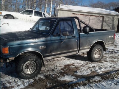

Right now, I've got a 1987 Ford F-150 with a 20k 302 and a 4-speed in it.
- New 302 (5.0L) EFI, less than 20k miles
- 188k on the truck
- 4-speed granny (Borg-Warner T-18)
- 4x4, manual hubs
- Good 32-inch tires
- Shortbox
- brackets and tubing for natural gas (no tanks or injectors)
- XLT Lariat
- Power windows, power locks, A/C
- Kenwood aftermarket stereo (no amp)

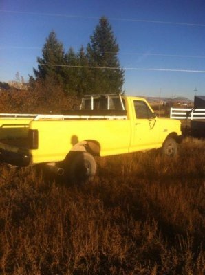

So, now I'm talking to a guy who is willing to trade my truck for his 1989 7.3l F-250 diesel. It has:
- relatively low mileage
- 4x4, manual hubs
- 5-speed standard
- 3.5-inch straight-piped exhaust (No emissions and no sound restrictions where I live)
- standard cab
- long box.
According to him, it needs a regulator, but that's about it. It has lower gears (I'm assuming 3.74's or the like?), but he doesn't seem to actually know much about the specifics.

I haven't actually seen the truck in person yet, so I haven't had a chance to check anything. All I've got are pictures. Mine's the blue one.
