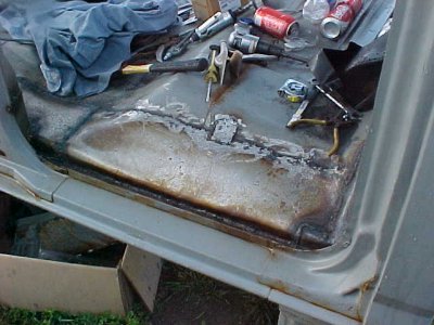

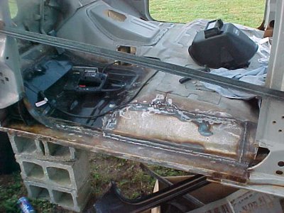

Well, got the kiddies tonight so the welding stopped early and have some time to update on Project Golddigger.
The first photo is a BEEEUUTEEFUL view. :love: :love:
Just can't wait to her her spool up now. :D :D
Look a bit different Calvin? ;Sweet
The remaining 4 photos are of the drivers side floor pans front and rear.
Plus a solid B pillar. ;Sweet
Man what a mess. Me thinks it would have been quicker to get a different cab, but momma said different. -cuss
Only good thing was I was able to justify buying a welder and am getting better at welding.
Still the dog catcher flock-o-pigeon welding service but hey, just started welding 2 weeks ago. :eek:
I got the passenger front floor pan almost all the way in tonight before the little Butts arrived home for the evening.
Hopefully if I can keep the pace, I should have the sheet metal repair done and the cab into primer and all areas that need cut in with paint should be done by Sunday evening......Weather permitting.

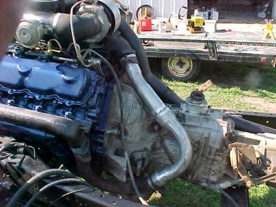

need to see some more pics of the up pipe welding job. heck...more pics of the engine period. ;Sweet
silly question.....have you checked the floorpan will clear the pipes?

Looking Good Ron. ;Sweet What did you determine about the up pipe? :confused:
BTW your concrete blocks are turned wrong(holes go up). :Sly
Here's 2 more for ya. I gotta get one of the air box color matched and painted. :love:
I took quite a few measurements from the Beef plus checked with a couple others and things should be good and snug. :eek:
Just gotta notch the pinch weld and roll it back yet. Gonna get some color on it first before I roll it back.

Custom fabbed up pipe job. $100.00 to come pick up the chassis run her to the shop, weld her up and run her back home.
Gotta love that '50' discount. :Sly

Yep, I didn't have much choice with what little solid metal was left on the B-pillars. :eek:
Prolly caused the 2 cracks on the passenger side floor pans just below the firewall. Heck the one was 6 inches long and has spidered out in 3 different direction. :puke:
Oh well rain not coming so back to welding I go. :D
