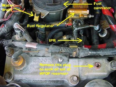

Don't know a great deal about the early PSD's. When I have trouble I have the AE scanner to help me out, pull the codes if any. If the SES lite comes on, then there is codes to read. The most problems with the PSD is the CPS (Cam Positioner), the UVCH (under Valve Cover Harness), this harness connector likes to come partially unplugged under the VC, mostly drivers side, the 97's have two connectors each side, the ICP (Injector Control Pressure sensor), the IPR (Injector Pressure Regulator). If the 30 amp fuse blows IIRC #22, that feeds the fuel heater in the Filter and PCM. Below is the replacement for the heater. I don't know why your HPOP reservior was empty, but it is kept full from the Low pressure pump, possible the pickup screen in the oil pan is partially plugged. The EPR (Exhaust Pressure Regulator) will give you trouble also, the tube going down to the exhaust will plug up or have holes rusted in it, the sensor will become plugged also, Here is Guzzles maintenance, it's for 2002 but all PSD's are close, use what you can. http://www.guzzle7pt3.com/ebps.php http://www.guzzle7pt3.com/index.php
Heater is available from IH dealer $26.

When it won't start on the first couple of revolutions, check the HPOP reservoiur to see if it's full, should be just 3/4" down from the top.

When you check it do you pull the plug to the right or the sensor or dose it matter? Also, are you supposed to suck that oil out periodically, I heard that but never knew for sure
338
Why would you pull a sensor when there is a fill/checking plug? No need to suck the oil out, the oil is constantly being changed when the engine is running.
