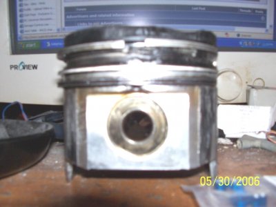

It sounds like a bad injector. It will break a piston if you let it go.

How do i tell which injector it is??? i didnt know it would ruin a piston!!!!!!!!!:eek:
